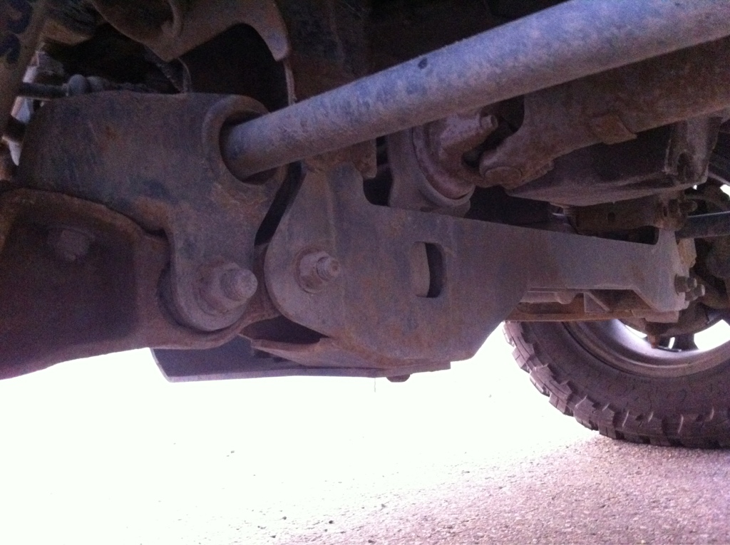

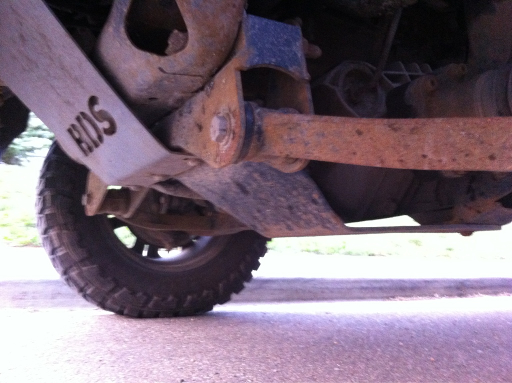

I believe RCX moves the back end of the torsion bars and keys down instead of mounting a new spot on the A-arm, I don't know much about them though, all the ones I have seen move the A-arms and torsion bars in some way
Sent from Team Sierra
Front crossmember
Rear cross member
You can see where the torsion bars new spot bolts on the old spot pushing your A arm down and lifting the vehicles front end up, and you can still turn your keys up if you wanted, just to the might of the torsion bar is where I had to cut part of diff support to slide the rear crossmember in and where the diff is supported now

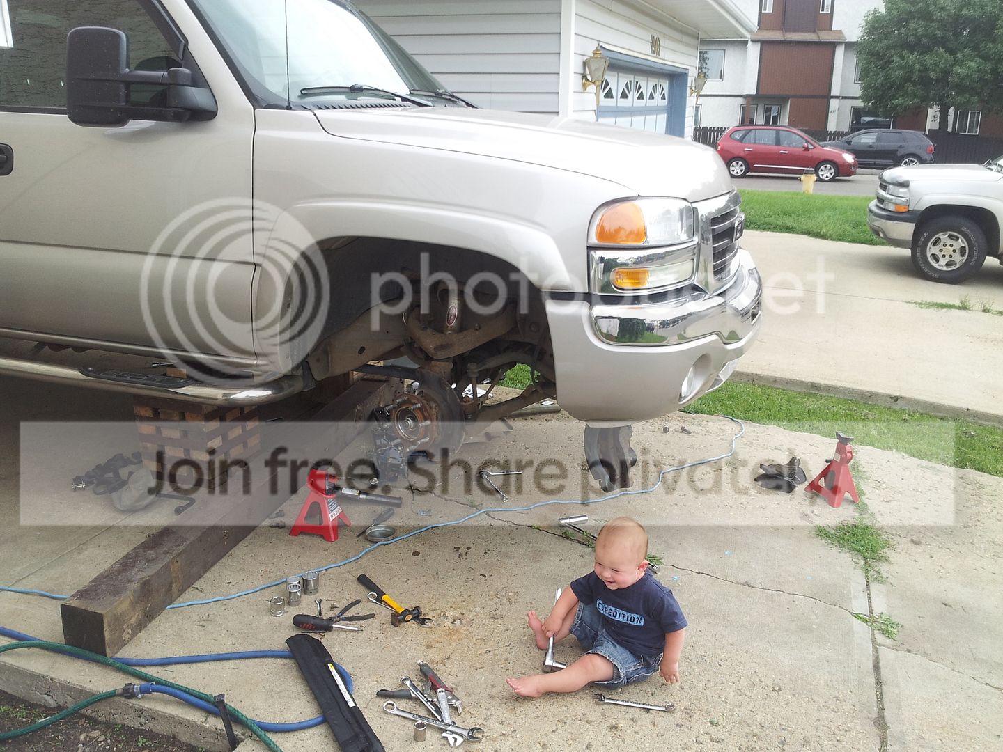

With all this help it might take a little longer. We've got the brakes off, torsion bars unloaded, all the nuts loose and ball joints broke loose, as well as the cv bolt. Ready to take the knuckles off tomorrow evening.
