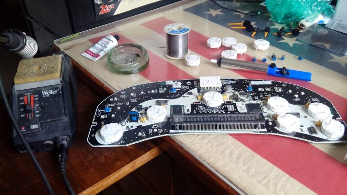

Anyplace online that will replace a gauge cluster and heater control? My lights went out on my cluster and I tried to fix it by replacing the lights. Boy did I butcher that. Any recommendations?
I ordered the kit on amazon and redid the whole thing myself. Pretty easy if you take your time and get the one with the solder remover.

No just the cluster. I replaced all the bulbs and step motors. My AC control was also acting up and tried a Dorman from Amazon that didn’t work so well so I bought the exact model on eBay for 50.00 and works perfect.

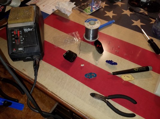

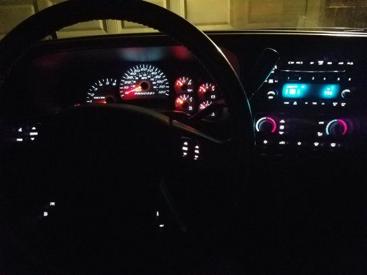

I did the LED light upgrade on my 06 Suburban cluster and a few months later I did the electronic auto HVAC module. I don't remember it being too difficult, just takes a bit of time/patience.

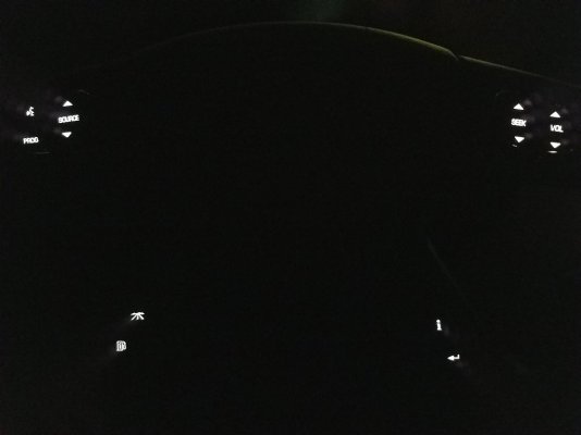

I was supposed to do the steering wheel buttons but I forgot about that. Mine have a few that are burnt out. There's also kits for LEDs for the modules for 4x4 and the headlamp/fog light switch IIRC.
When it rains it pours. So now the stepper motor went out for the temp gauge. Lots of options to choose from to fix it or replace it.
If you have the capabilities, you will want to attach a live data scanner and make sure the coolant temp sender is good. Your stepper motor may be fine.
I did all the steppers and bulbs in my 2006 cluster. Also did the bulbs in the dual zone/automatic ("digital") A/C panel, and the steering wheel buttons. IIRC the digital A/C panel has two different types of bulbs in it, 12V and 6V
The whole reason for this job is my fuel gauge stepper went bad during a battery cable replacement. Figured since they're known for failure I did the whole thing.
This is the kit I used for my 2006 SS since it has the extra stepper for the transmission temperature: https://www.amazon.com/gp/product/B01J50FOBA
These are the "grain of rice" bulbs I used in the steering wheel buttons: https://www.amazon.com/gp/product/B00L8BR76A
And finally here's the climate control bulb kit; note that you have to pick auto or manual on the controls as the bulbs are different: https://taninautoelectronix.com/product/2003-2006-gmc-chevrolet-truck-diy-climate-control-bulb-kit/ - I wish I could remember the information source I used to determine which bulbs were which. There's two circuit boards in the controls IIRC...sorry; don't have pics of doing that one, but it really wasn't a big deal.
The only real PITA is the replacement bulbs for those small ones in the buttons and A/C controls don't come with the blue covers that give them the correct color; you have to carefully pull them off the old bulbs and transplant to the new. Sometimes they're crispy which makes it tough.
That’s exactly what my voltage one did, the kit with all new lights, stepper motors and even the tools needed was just 30.00 on amazon. I watched a few videos on YouTube first.
