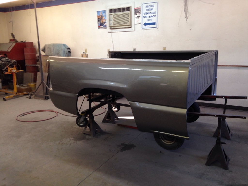

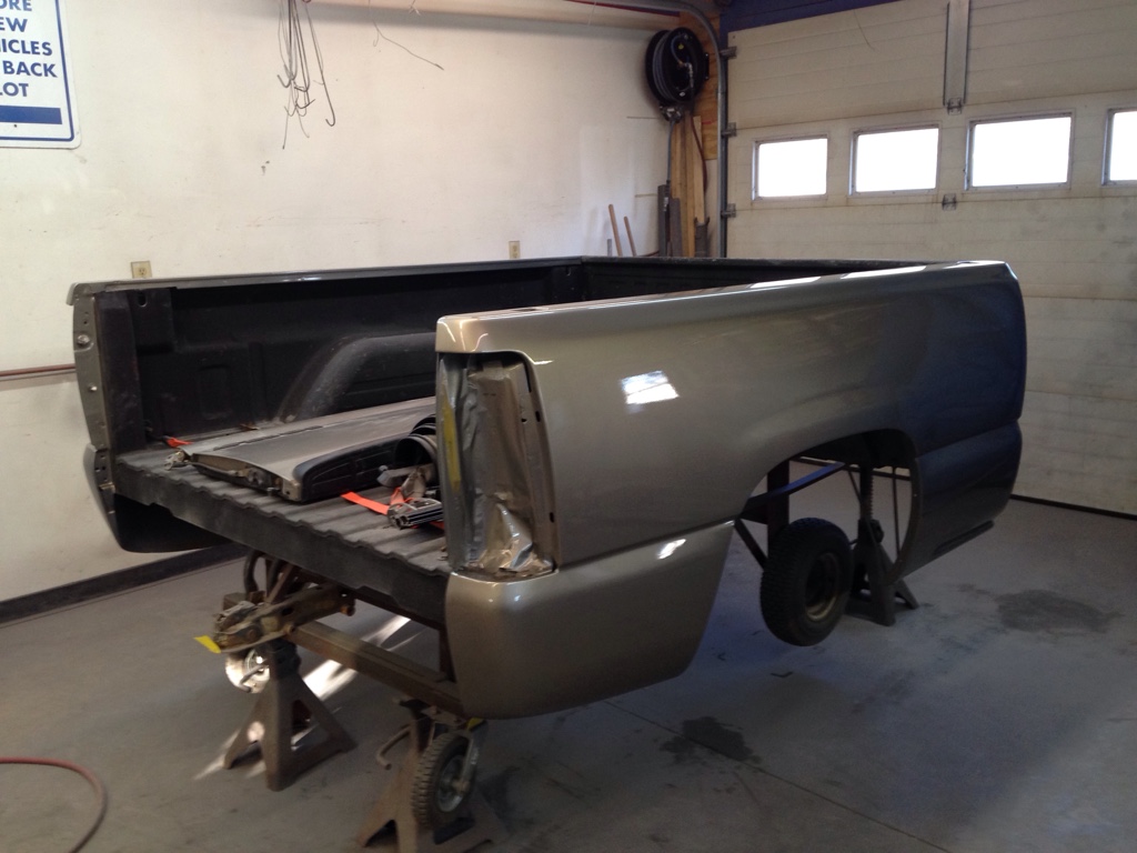

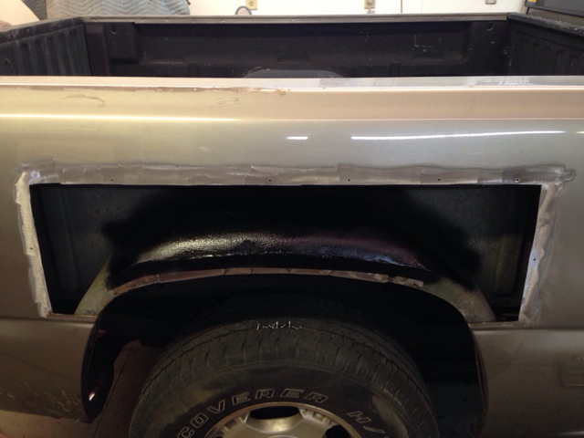

Got the other bedside done
After some filler to blend in the welds
It's primed that off blue color like the rest of the truck.
All I need to do now is buy a cowl hood and replace a door and start priming/painting

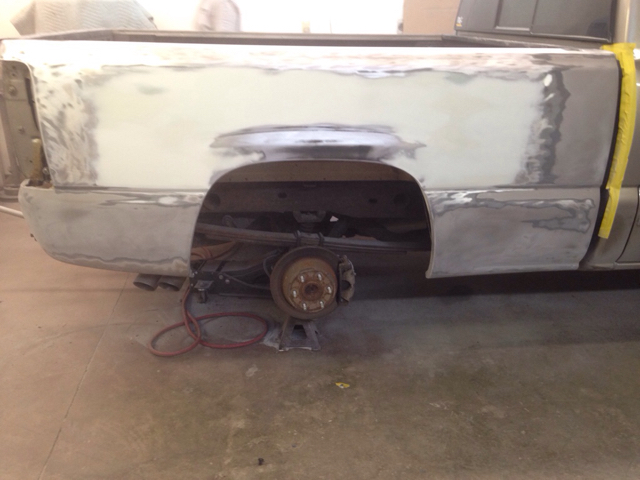

Thursday night I started pulling out all the old brake lines and most just crumbled in my hand. I got a new GM prebent kit and installed that. No pics because that is the biggest PITA ever. Also when I went to bleed the brakes the bleeders were stripped and not coming out so I got new rear calipers and did the backing plates while I was there. Later this year I will have to pull the axles and install new parking brake hardware as that was toast too.

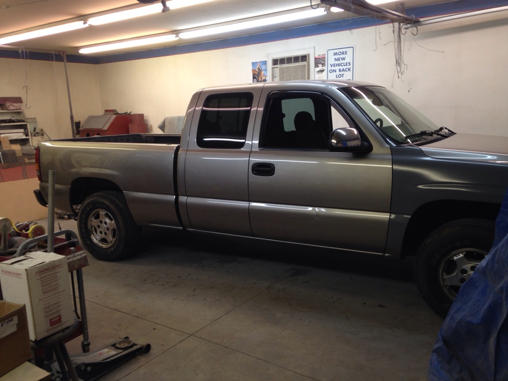

Since I pulled the bed off to do the rear lines my dad decided it would be a good time to do more bodywork. So we're doing some today and then going to put the bed on tonight so I can go to school tomorrow

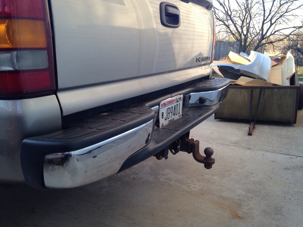

Installed
New rear bumper
My dads friend polished my tails
Lastly I demolded. I need to buff out some lines and it shows off how bad my passenger side door is

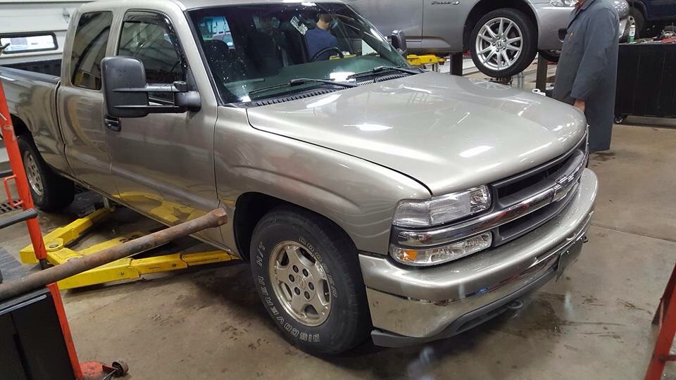

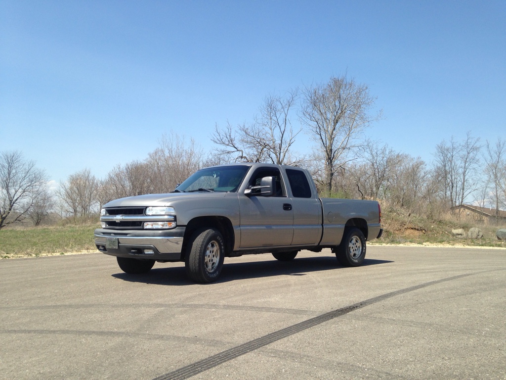

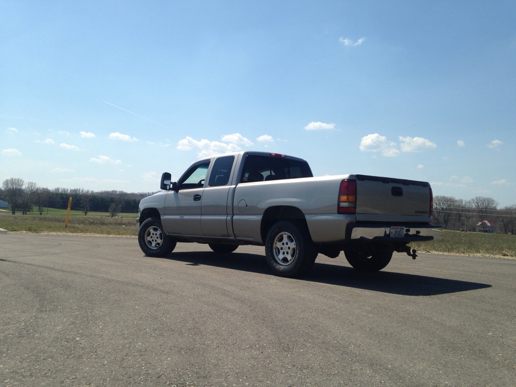

My birthday was last Saturday (4/16) and I was given some new truck parts!
I got tow mirrors and a painted bumper cap. Took the truck for a few nice pics with the new mirrors

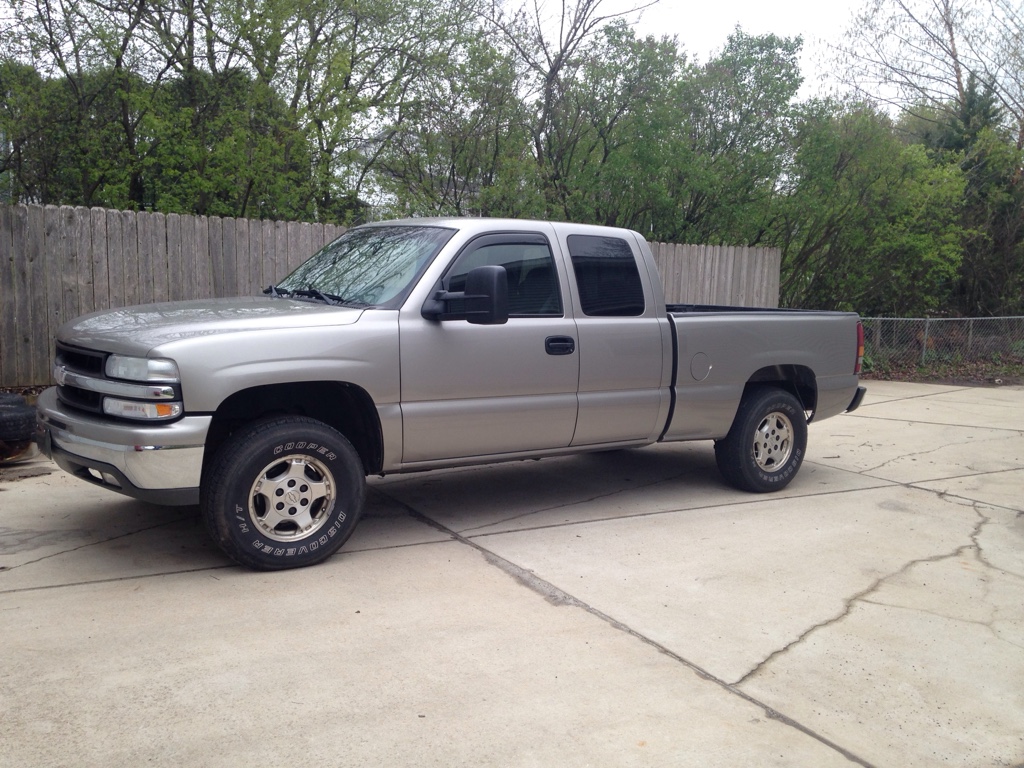

Basically the only pic I have with the new bumper cap (next to my dads 00 silvy).

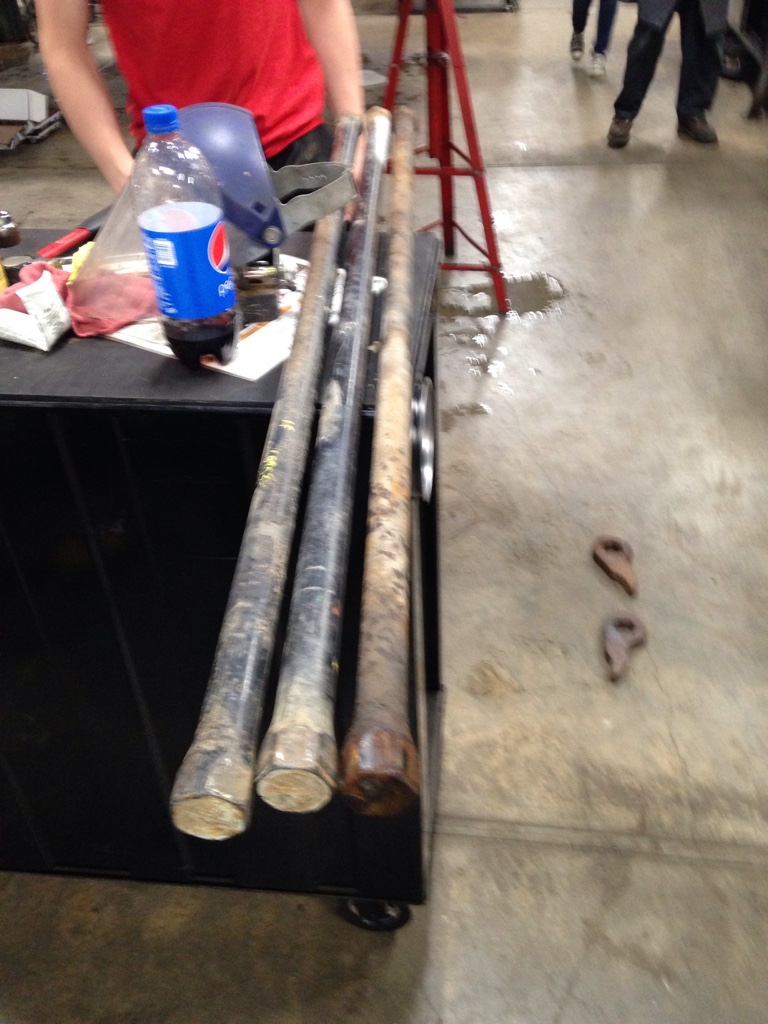

Today I got my 2500 torsion bars and I hope to get them in soon.

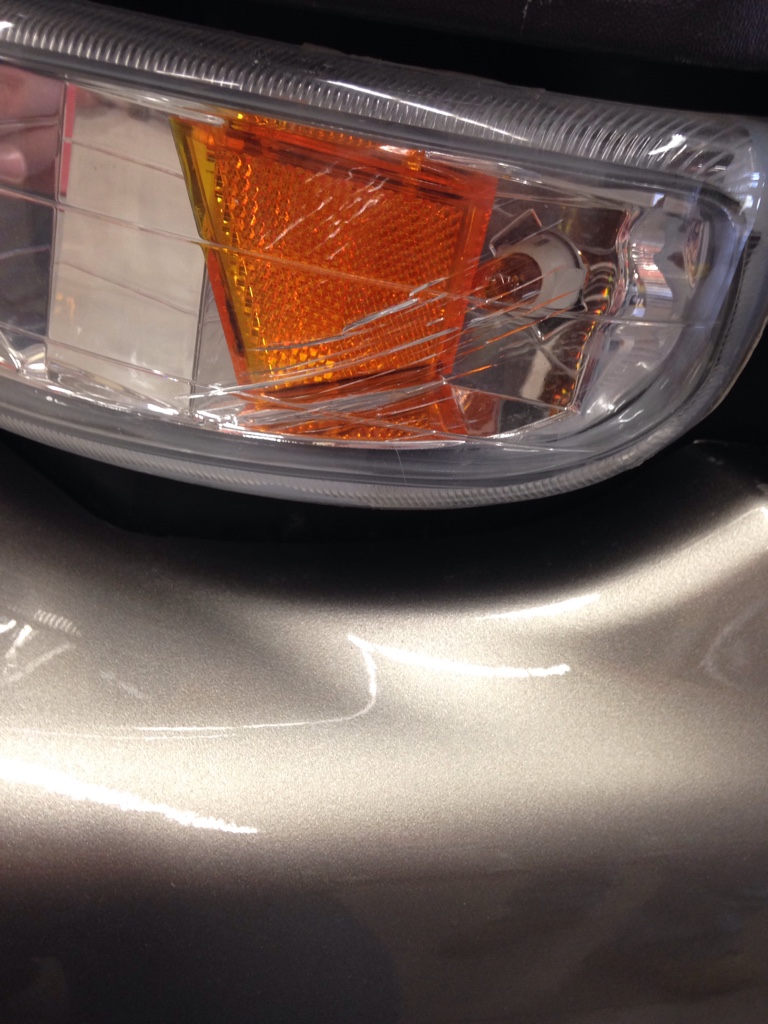

Almost forgot, these turn signals are junk! I have never hit anything or put pressure on them. Looks like I will have to scrape up $45 to get the nice Classic Industries signal housings.

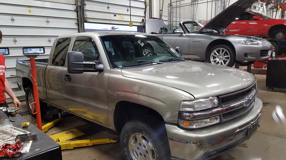

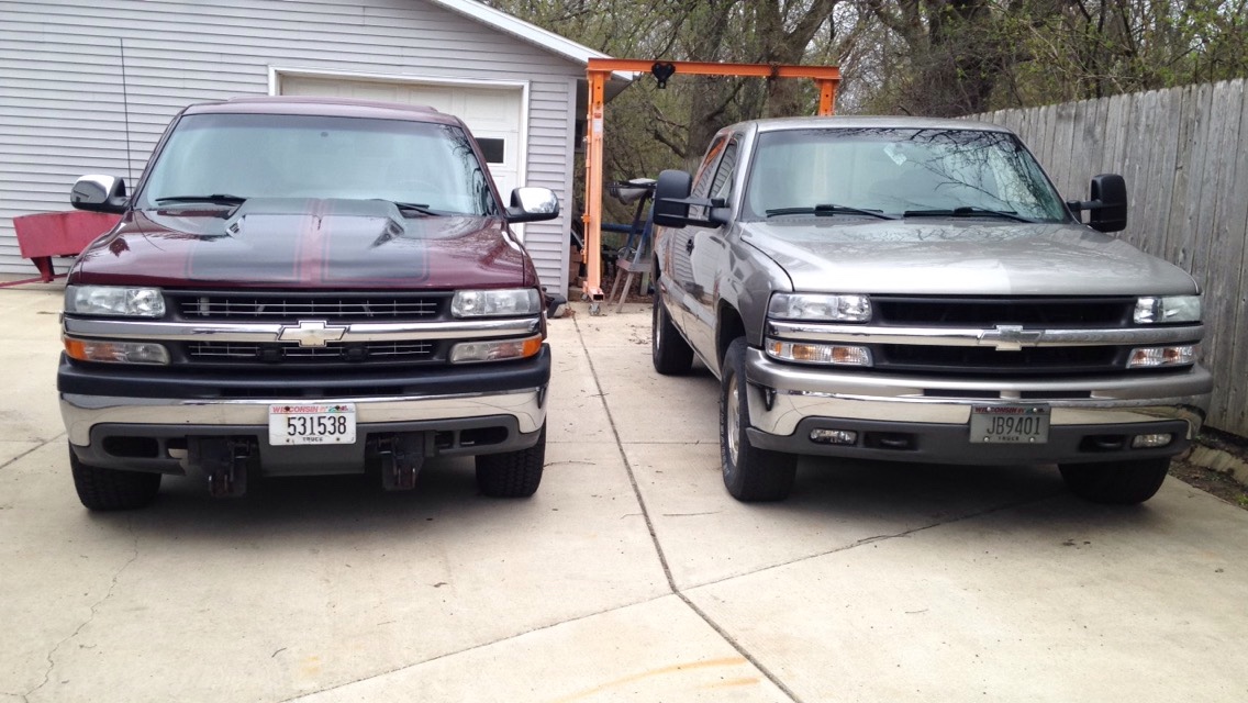

Actually yes. I got them installed last night. I did not do keys as in the 2500 trucks they use 1500 keys to lift/level it.
Here's a comparison pic. Both 2500s are to the left of a 1500
I put them in with the help of my friends, the first time we couldn't clock them right and tried to see if it would hold its weight...
It didn't. So then we took it all back apart and flipped the bars side to side and that seemed to be the solution

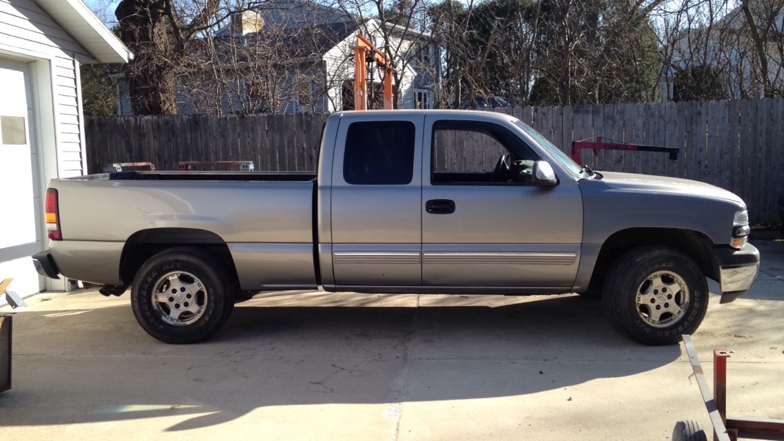

It sat about 38" on each side (right where I want it) but it settled over night to about 37 3/8" and I'm happy with that. It's 3/8" higher then the rear and still looks good IMO

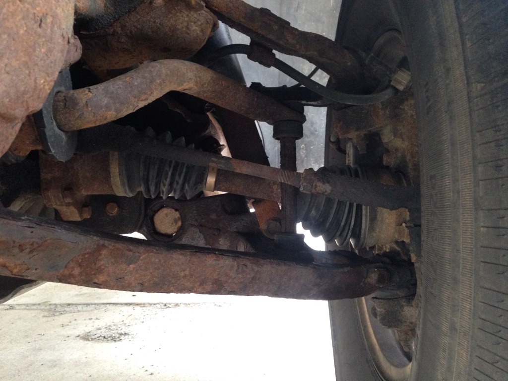

Here's a pic of the angles
