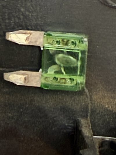

I found the frt hvac 30a fuses which was there. But no other ones.
The only 40a fuses are stud #1 and ign A which I figured that’s probably required for the truck to start and run, which it does without any issue right now.
This YouTube video seems to match my setup as well. This makes sense. I’ll check that 30a and see what its condition is. That might be my issue.

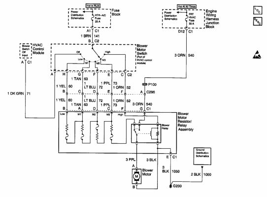

Also, apparently, the schematic that I was given was for a different vehicle/truck. I hope what you found takes care of it all.

I found the 30a fuse under the hood was blown. Swapped it out and now I have all 5 speeds. Unfortunately the motor was making a terrible screeching sound as it was spinning. So maybe my wd-40 / electric motor cleaner trick wasn't enough. Oh well I had ordered a replacement blower motor anyways so swapped that in today and all is good. Got the panels put back together. Also changed the flasher relay to solve the hyper flashing led turn signals.

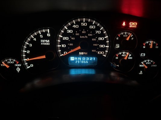

Also got the bulbs replaced on my gauge cluster and re oiled a couple of the air core motors for the oil pressure and fuel gauge as they were a bit loose (“helicoptery”). Seems much better now. I don’t remember before but the lower right corner of the cluster still seems dark to me but I don’t see a bulb down there so maybe that’s just how it was. ‍ I’ll get some pics later.

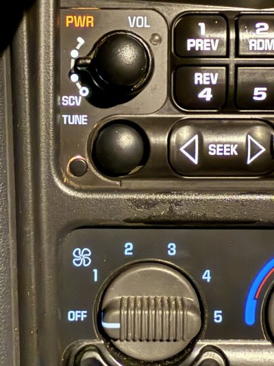

Not a huge fan of the blueish led backlighting on the hvac controls. I’ll fix that eventually.
Cluster actually looks pretty good in this pic. Bottom right doesn’t look as bad as I thought.
Bluetooth button on the factory modded stereo.

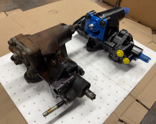

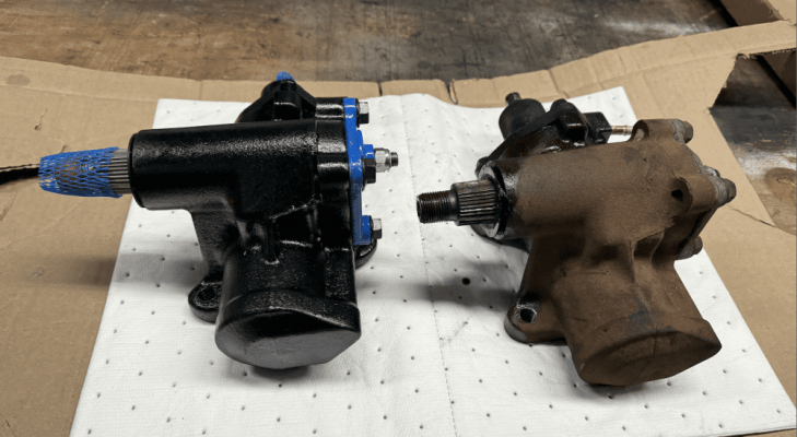

Well got the steering gear box replaced with a bluetop unit, new Napa power steering pump and high pressure line. Got it all bled out but steering still feels pretty heavy. Definitely got rid of the sloppy dead center feeling. but compared to others it definitely seems to take a lot more effort to keep the wheel centered as it doesn't return to center completely. It will return to center about 80% of the way. needs help to get completely back to center. Overall drove nice just a but heavy on the steering for comfort. I'm planning to pull the tie rod ends off the knuckles and see if they turn tight on their own. if so I may have got too tight on the ball joints. will check tonight or tomorrow before the rain returns.
Aside from that, replaced all 3 joints and the center support bearing hanger on the rear driveshaft. 300k miles, the u-joints were actually in really good shape. the bearing was actually good too just the rubber surround was trashed. got that all back together runs smooth down the highway so im happy. no more shudder feel on takeoff.
Finally changed out the oxygen sensors due to P0420 CEL that came up last week. Hopefully that keeps it happy until I really need to replace the cats. No CEL yet. I'll report back on the findings of the steering.

Pulled off tie rods from the knuckles tonight and the knuckles turn with some resistance but not what I would think is excessive. Started the truck and turned the wheel without the knuckles connected and there’s definitely still heaviness when turning but noticeably less then when it’s all connected. I wonder if the idler/pitman or idler bracket is binding/stiff. To be honest the more I drive it starts to feel less “heavy”. At this point there’s no slop anywhere and generally the steering feels good. I think I’m going to put some more miles on it and see if it loosens up a bit. It’s definitely not as heavy and sloppy as it was before I changed the box and pump. That was a bit of a handle at times.
I think that about does it for suspension, driveline, steering and brakes for now. Now I need to work a bit on the interior cleaning and get those speakers changed out. I’ll see how much time I get over the next week with the rain coming in.
