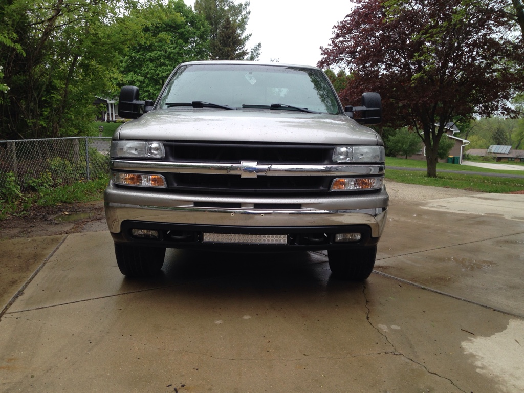

Got the light bar mounted until I make new brackets. Painted the valance too although I'm not sure how long the paint will stick
I've also been thinking about taking my tow mirrors back off in favor of the stock mirrors

I second the removal of the tow mirrors. Color matched stocks would look good

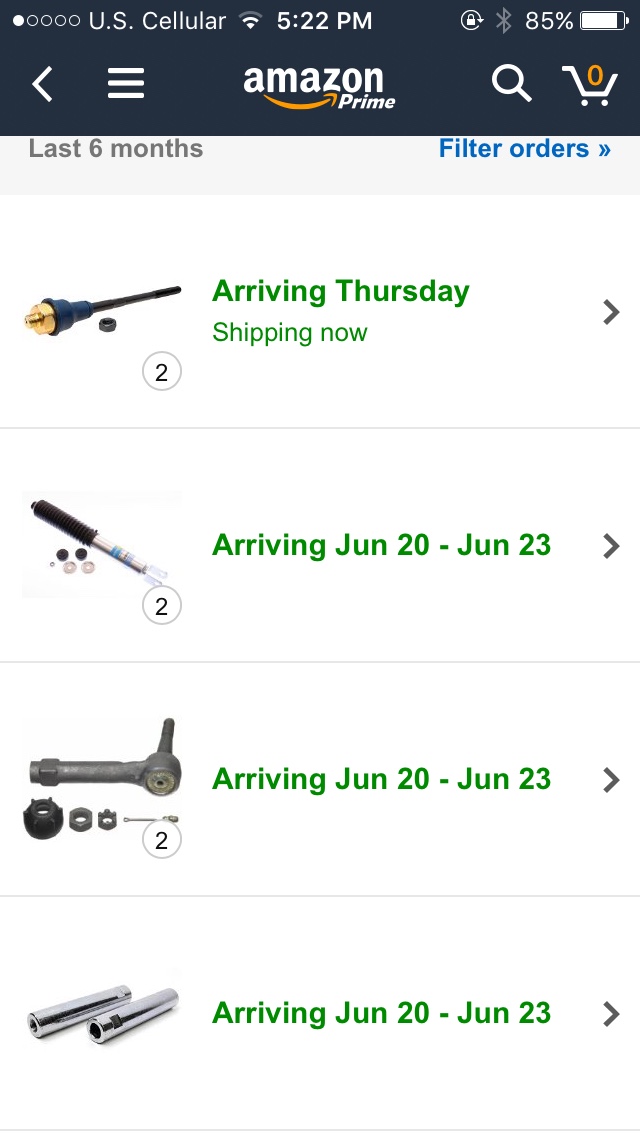

Got some goodies on the way. Need to get pitman and idler arms also

What brand? I'm overdue for some on my 05
Ac delco inner so I can use the rough country sleeves and moog outers. But I'm kinda worried about the moog parts because I heard their quality is going down hill
