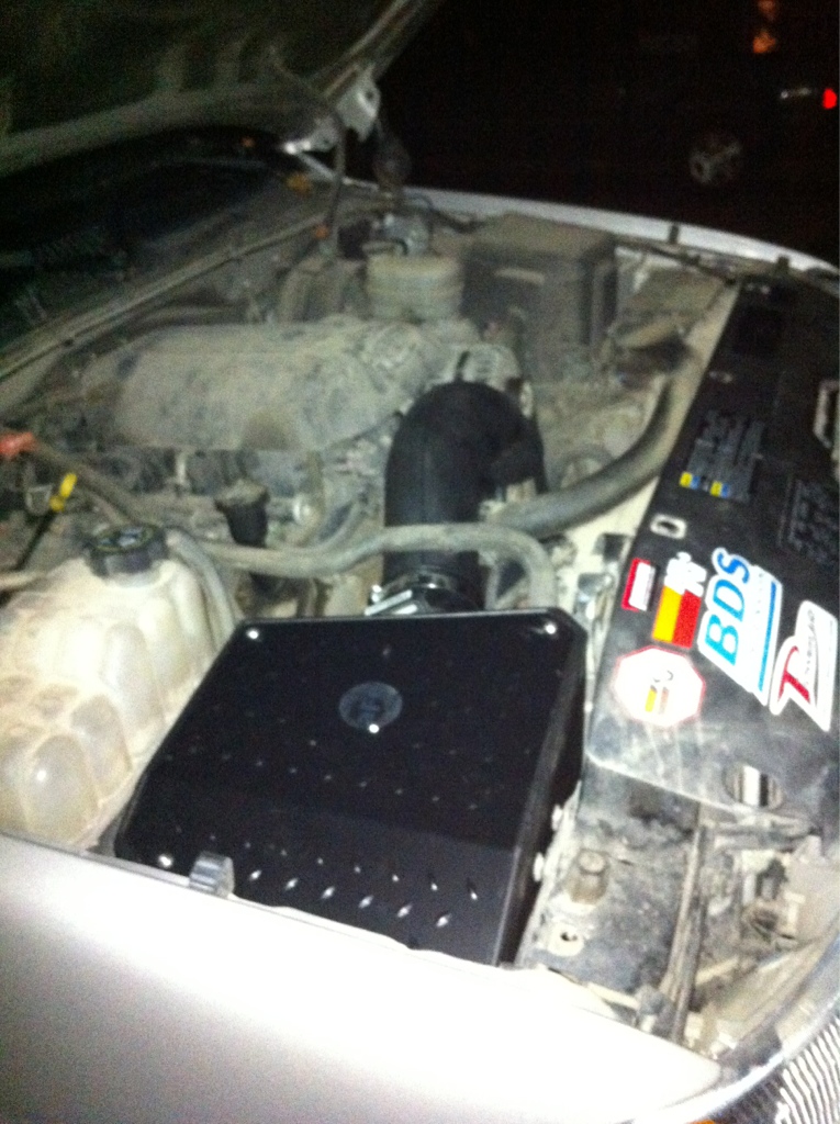

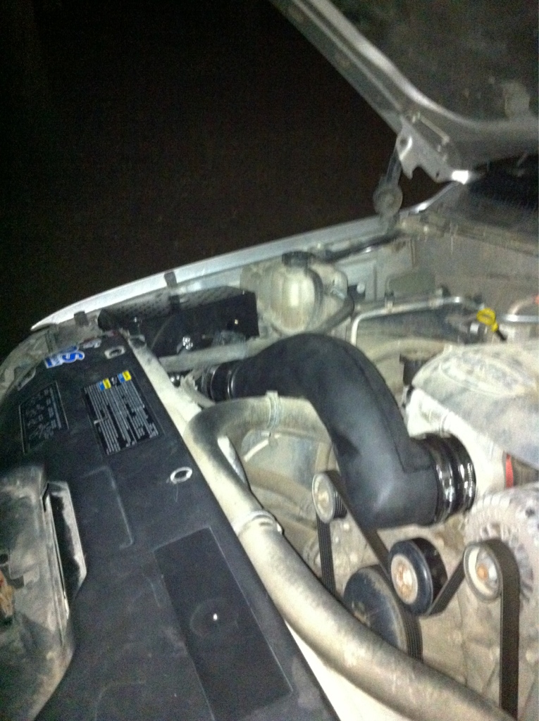

Sorry for the bad quality, got it in, had to drill a few holes out bigger, intake tube was not fun to get in
