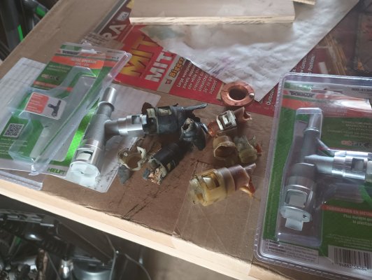

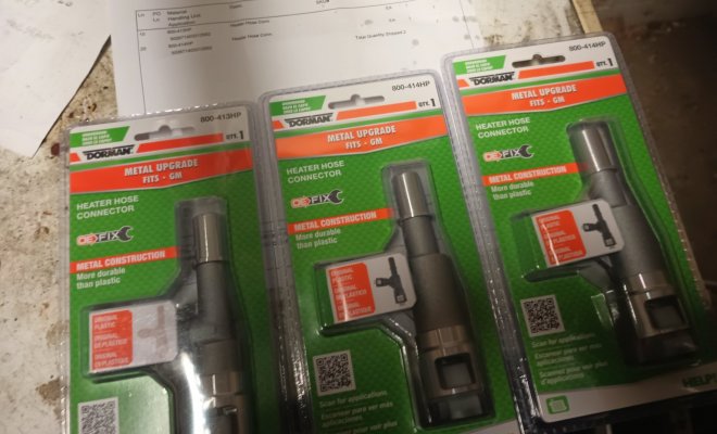

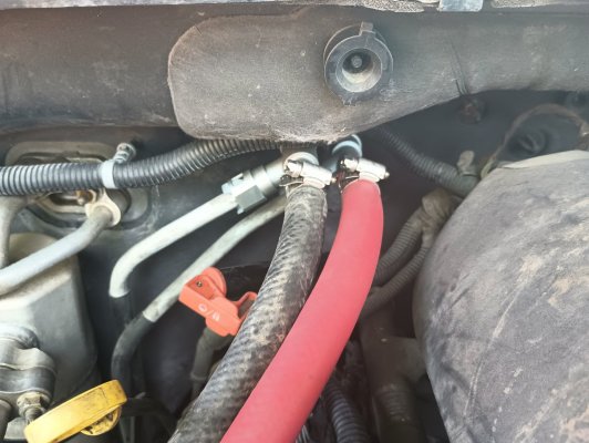

Here's the heater core tees Dorman makes. I couldn't remove my old ones, so I just broke them off with plyers. They definitely get brittle with age.
I decided to remove the quick connect integrated to the hose that comes from the large tee that hooks up to the reservoir. O'Reilly's only had red hose, so that's what I had to use. Whatever.
On my Silverado I have the hoses hooked up directly to the aluminum tubing, but the SUVs have rear heat, so you can't do that. Hopefully these metal ones last a long time...

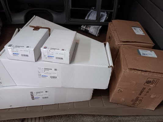

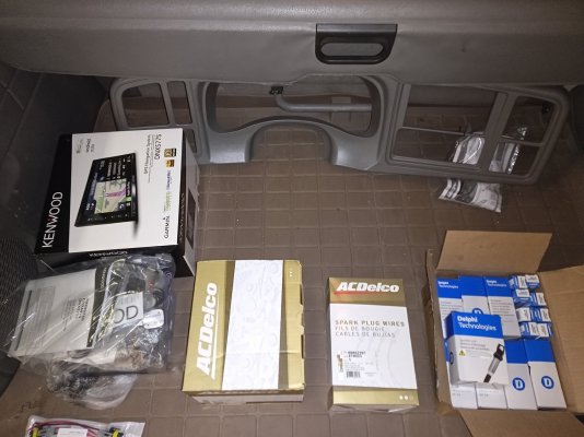

Got the dash camera installed, still waiting on a ton of other parts! Backup camera, CB, alternator, fog light plug, front shocks, coils, plugs, lower ball joints, tie rod ends, upper A arms, and hub assemblies are either in shipping or not shipped yet.

The waiting game. Get parts and put 'em on quick so you are ready for the next parts.

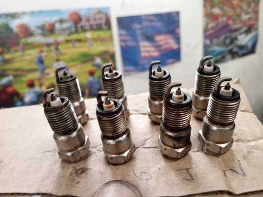

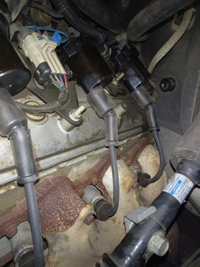

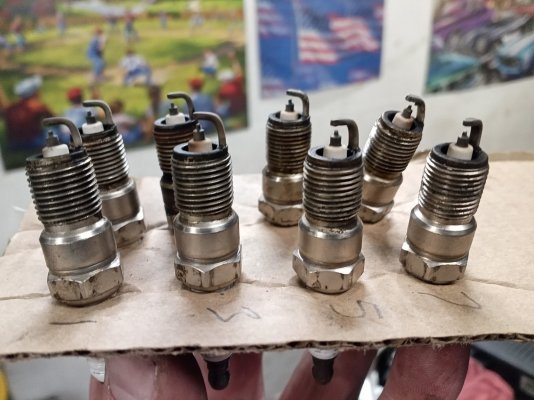

1. Complete, it was a missfire code that went away with the coils, wires, plugs tuneup. Runs so smooth now!

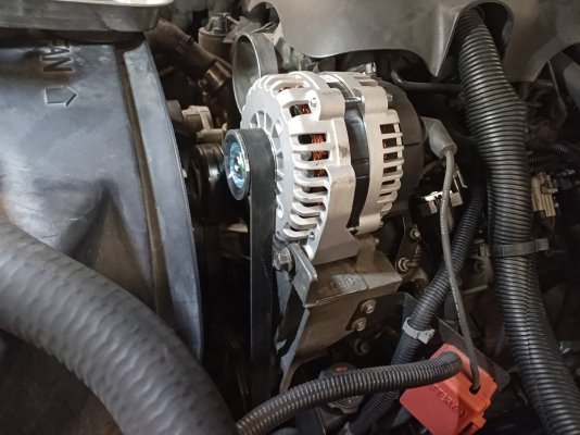

10. Number 3 should have been a once over on the whole truck, because that is what my son and I did. Found a bad alternator bearing and bad front wheel hub assemblies. Replaced alt, ordered ball joints, hubs, tie rod ends, and front shocks. Recieved all but the lower ball joints and shocks, so I think I am going out to work on it now.

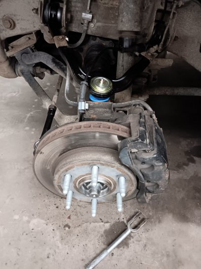

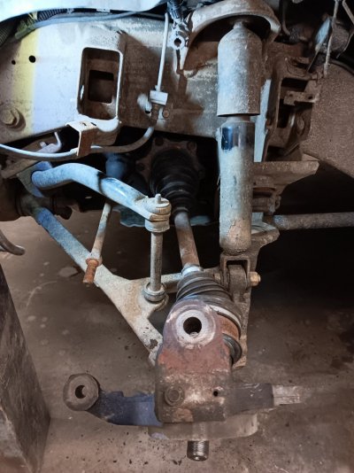

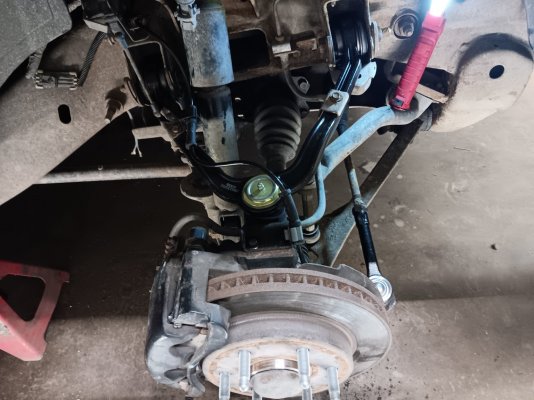

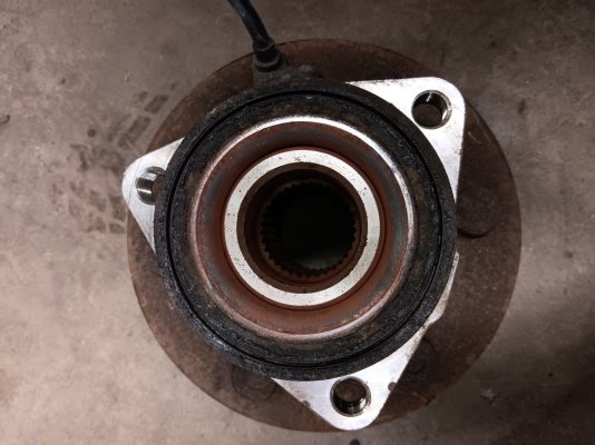

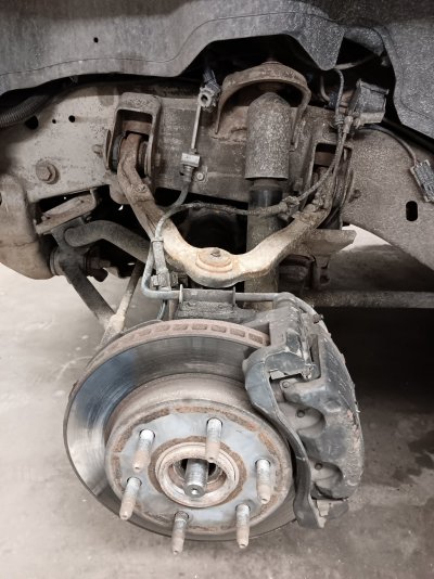

Here is today's progress. Hub assemblies, outer tie rod ends and upper A-arms replaced. Now its wait on parts for the next session.
View attachment 2678View attachment 2679View attachment 2680View attachment 2681View attachment 2682View attachment 2683View attachment 2684
evidence of loose fitting splines into the wheel bearing, they look worn
make sure you never use impact on CV axle nut , and you make sure its torqued. Usually need to put a prybar or large screwdriver into the rotor with the brakes on so you can prevent rotation
2,646
4,846
I did not know that, learn something new every day. Thank you!
Yea, upper and lower control arms need to be tightened/torqued while in the loaded position. Down on ground. You can snug them up but final tighten is on ground. Otherwise the rubber bushings will be loaded wrong and can cause handling problems and tear.
