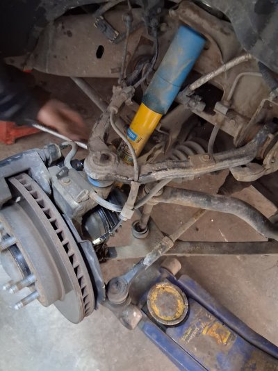

Rear brakes done! This truck will be new soon. Might even get to the rust issue and fix that.View attachment 4285View attachment 4286View attachment 4287
I dont see any lube on the brake pads or the clips , so not complete.
I also dont see any cleaned up hub from the rust shown before, or any anti seize evidence under and above the hat (only need a tiny bit to keep the wheel mounting surface from getting rust jacked, and the amount under the hub to keep that from rust jacking at all)
