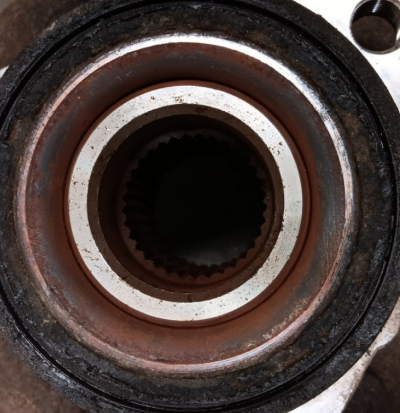

Here is today's progress. Hub assemblies, outer tie rod ends and upper A-arms replaced. Now its wait on parts for the next session.
View attachment 2678View attachment 2679View attachment 2680View attachment 2681View attachment 2682View attachment 2683View attachment 2684
evidence of loose fitting splines into the wheel bearing, they look worn
make sure you never use impact on CV axle nut , and you make sure its torqued. Usually need to put a prybar or large screwdriver into the rotor with the brakes on so you can prevent rotation
I did not know that, learn something new every day. Thank you!
Yea, upper and lower control arms need to be tightened/torqued while in the loaded position. Down on ground. You can snug them up but final tighten is on ground. Otherwise the rubber bushings will be loaded wrong and can cause handling problems and tear.
