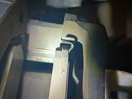

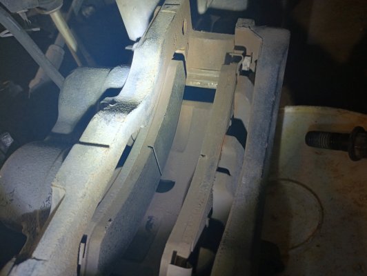

I checked the pads and I have plenty of life left on them. I replaced the front rotors when I bought it, according to my maintenance records, but not the pads. That was at 225k and currently at 273k...I guess I'll just keep on running them?
Also, I didn't realize how friggin' massive these front calipers are, in comparison to the 2019 calipers I swapped on my 99 Silverado, these seem larger and heavier.

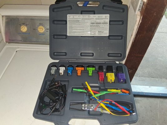

I ordered one of those Lisle master relay tester kits, and hopefully I can figure out what's happening when it won't crank...stand by, I guess?

I got my relay tester, but now I can't get the minivan to act up. Been checking for the last 3 days and she cranks and fires right up. WTH.

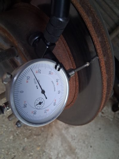

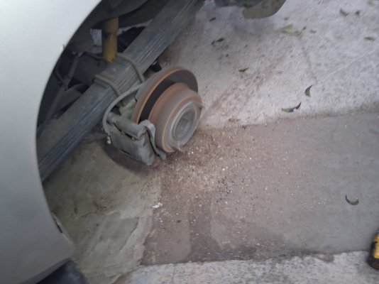

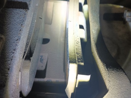

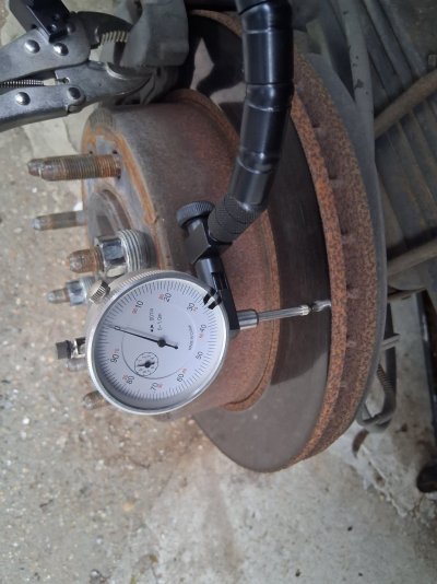

Also, I jacked up the rear and took off the tires. I had my son put it in gear and I could see the little brake pad ears through the caliper were moving back and forth. I "think" that's the pulsing when braking and I also have this kinda weird "uneven deceleration" when coming close to a stop.
So I proceeded to measure the rotor run-out and got about 15 thousands on tbe driver's side...that's a lot, so I didn't even bother measuring the other side. SMH

Back to my Suburban, that GM Genuine sensor didn't actually fix the issue. I now have a code about missing signal for that sensor and the others are gone. There was a shim on the Timken, which I reinstalled. Maybe that had to be omitted?
Here a video I created. Hopefully you can see what I'm talking about on the pads moving around:
You can machine them and likely be fine. If you do, make sure before a shop resurfaces them that they or you completely clean the inside/backside of the hub hat. When you put the freshly machined or new rotors on, make sure to clean the end of the axle. Rust build up. You do what you want but I would use new pads and hardware and clean/adjust if needed, the park brake shoes.
