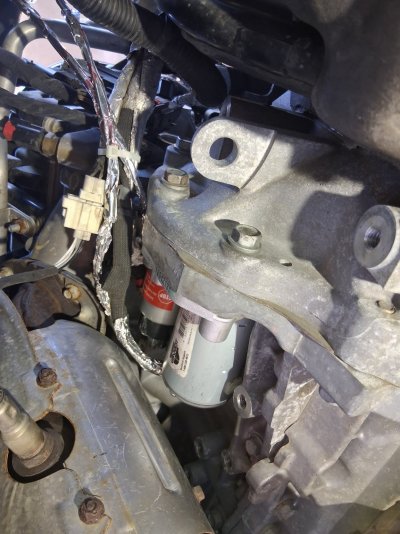

I really should check power at the solenoid, but no easy way. Unless I clip an alligator wire and run it to the top of the engine. The catalytic converter, engine mount and a cross member are in thd way. I checked All data and they actually show removing the catalytic converter to remove the starter, which I managed to do without.
No way a new starter acts EXACTLY like the old starter. Attach the clip and run the voltage tests.
OK, will do. I may actually have to remove the cat, because the electrical connections are very tight behind the starter.

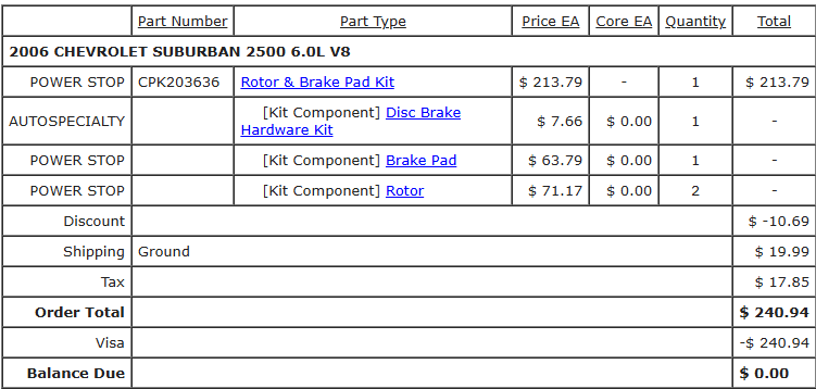

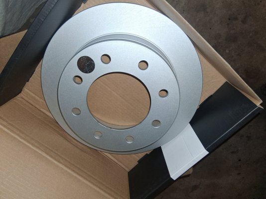

Got the rear rotors/pads in the mail for the Suburban today.
Both COO said made in 'Gina...kinda disappointed, but oh well...SMH. Hopefully they are good enough. Fingers crossed.

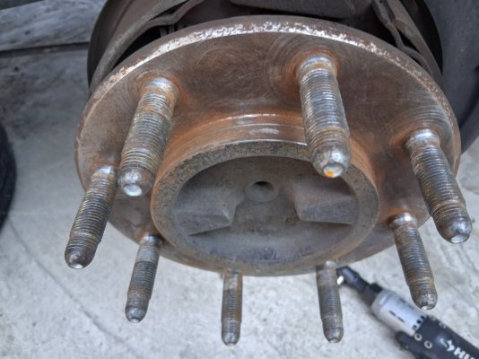

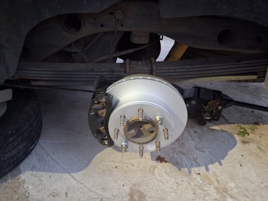

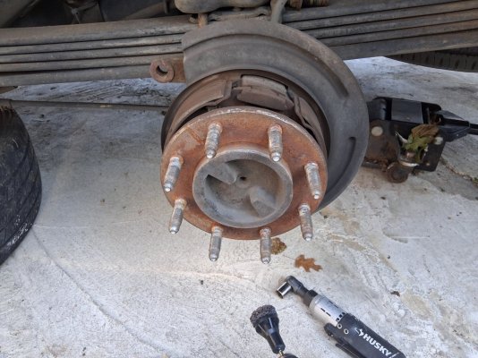

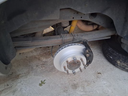

I did replace the rear rotors and pads on the suburban. I had bought the little drill attachment to clean around the wheel studs but it didn't work over the stud because it bottoms out before the abrasive surface hits. It's the Performancetool brand. So I had to do some wire brush and sandpaper.
Edit: I see i need to replace the rear jounces...they are missing.

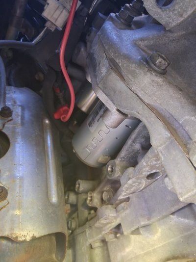

I just a voltage drop on the minivan and got these results. Power voltage drops looks a bit high, but IDK about the other stuff.

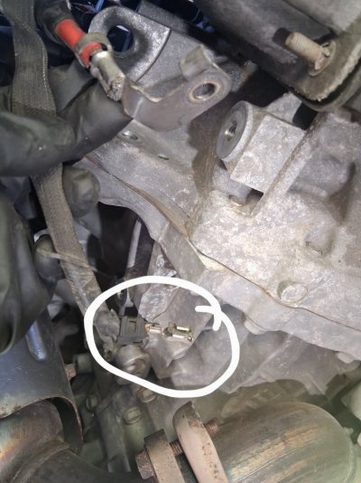

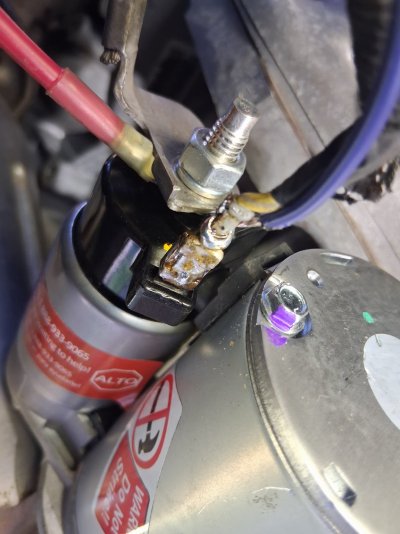

I had the little plastic connection on the solenoid break last time. I thought the actual metal terminal was still making good connection, but wasn't sure...so I soldered in, since I didn't have any spade crimp-on connectors that wide. I also soldered a new wire and ran it to top, for testing later since this thing is buried in there.
And I ran another power cable to the positive to help with that voltage drop that seemed a tad high.
Edit: something is wrong...I can't upload photos...
Not sure why I can't upload photos from my phone now? But that circled part is the solenoid plastic tab that broke. I found a thread on the minivan forums some guy had the same issue with it breaking. Another member said he too was having intermittent issues also where it wouldn't crank, and moving the harness around fixed it, until it happened again and it was that connector not making good contact. Hopefully that was my issue too. I'll continue driving it this week for another few days before handing it back my wife. Seems like it cranks faster now also.

Suburban braking shake is also gone! Braking is so smooth. I'm happy :)
