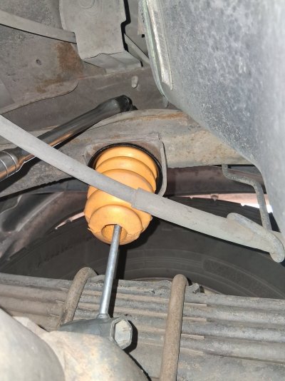

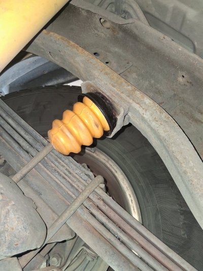

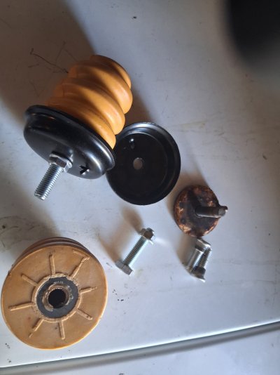

I bought the rear jounce stops from "the jungle" of Amazon. I'd bought these same ones and installed them on my Silverado w/o issues last year.

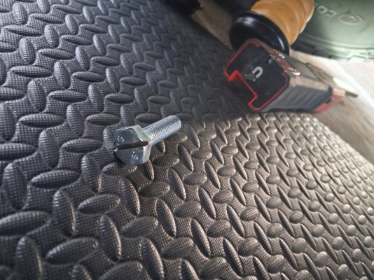

Well, on the Suburban the studs were too short. The inside frame rail has a spacer or something. I went and bought longer bolts and was going to tack weld to the metal part, but decided to just cut a slot on the bolt head to prevent it from spinning.
I had to use a weedeater spark plug tool with a flathead so i could clear the axle tube. Job took way longer than anticipated.

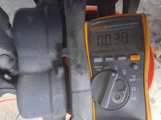

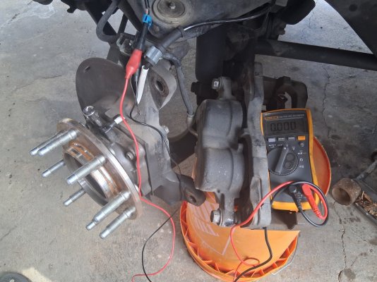

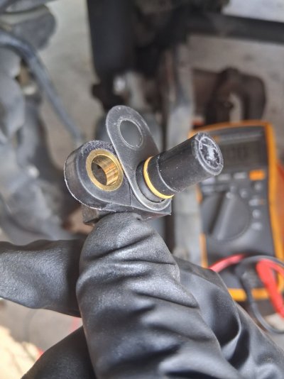

I bought another front speed sensor (from AAP) because the GM Genuine didn't fix my issue. Recall that I reinstalled the little shim that the Timken had.
Yesterday I tested the GM Genuine with a DVOM, and no AC signal was being produced while spinning the wheel hub. I tested the AAP outside, and getting it close to the wheel studs, did produced some voltage.
So reinstalled the GM Genuine and removed the spacer and confirmed signal was being generated now. The faster I turned the wheel hub, the higher the voltage (still very small voltages albeit.)
But still same code. Doh!
I'll try my luck with the AAP sensor now I guess. If that doesn't fix the issue, I'll have order another replacement hub.

Well, the ABS light is kicking my butt... light came back on. I went ahead and replaced the AAP Carquest replaced and nothing.
So I gave up and ordered a new Timken bearing from RA.

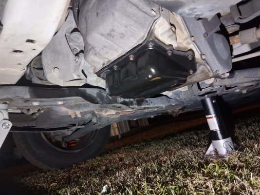

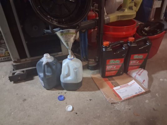

I'm back on the minivan: today I decided to do an ATF fluid replacement. It's got around 97k and the owner's manual said something like 90k severe service, 110k normal service. The other day my wife said the money light came ON and I checked it and it's a transmission TCC code. Had already planned on the ATF fluid service.

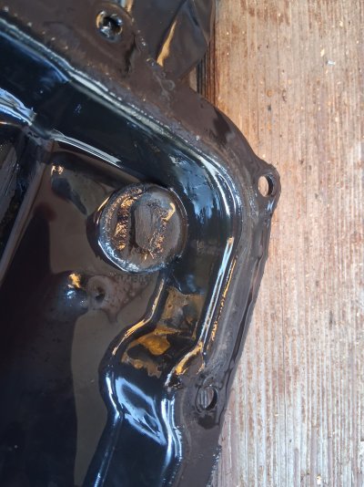

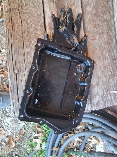

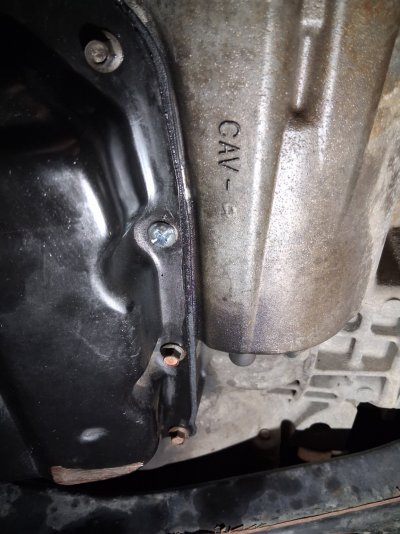

I'm done for the night though...1. I stripped one of the pan bolts heads. 8mm pan bolts, seriously? almost as good as if they'd used drywall screws. 2. The oil filter broke at the neck. I had to chisel it out in pieces. 3. The magnet was loaded with grit. 4. I just stripped a pan bolt threads reinstalling the pan! I was using a 1/4 torque wrench, and some of the bolts had started clicking. I think some of threads had silicone, maybe that messed up the torqing?
Ok, this is another day :) and I could use some brainstorming and wisdom.
Should I try my luck refill the transmission? Or should I try fixing that stripped thread? I have a basic SAE/Metric tap and die set, and a mostly complete drill bit that goes to 64ths.
I'll probably head to the hardware store to see what bolts they have there. I believe this little mom and pop hardware store even has Helicoils, although I've never used those before...
@stutaeng, I personally would do the complete transmission service and filter change. No flush! Personally, when I do work here at home, I run a tap in holes on most of the holes I took a bolt out of, before reassembly, especially if I am gonna torque them.
I would at least try to tap the hole and see what happens. Or see if you can find a self tapping bolt that fits.
I went and bought a M8 tap and screws, but decided not to try drilling it out because I'm not sure if that's a through hole or blind hole at that location. And I didn't want to remove the pan again.
So I installed a 1/4-20 screw in there temporarily. Refilled and went for a drive and seems like it's shifting well and no leaks. The tcc code had showed pending and it came back on, but I didn't really think the fluid replacement would do anything for that.
