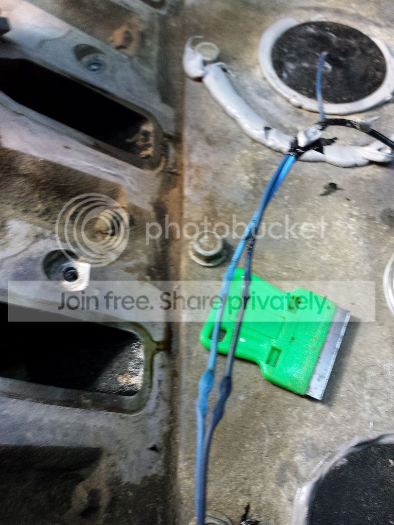

Found out why I kept getting knock sensor codes, used to just be sensor 2 but lately its been both. Well figured out after I took the intake off that the wires got pinched when I installed the sensors and harness awhile back. Repaired the wires and good to go now
i hate how often it seems like these knock sensors are failing, i should have replaced mine when i did my head swap
I've read a few repair threads silicone is important and running your wiring harness properly

I was a GM mechanic for several years and knock sensor and harness was a very common problem. Luckily these intakes are a breeze to remove.

Ya I replaced both the sensor and harness last fall because it was setting a code. The back sensor was all full of crap and nasty. Guess I had pinched the harness when I put the intake back on. Took me longer to solder and heatshrink the wires than it did to pull the intake off.
