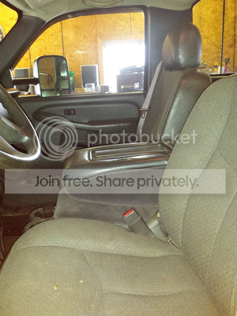

squeaky3
142
Pontiac Il
Installed a console jump seat in place of the just work truck middle seat that doesnt fold. Also installed my cb radio and my light strobe module.

i wouldnt mind that console, they dont have it for a leather interior though huh?
I dont think they have it for leather. I thought the leather trucks had the full console. I would love to have a full console but I have the 4wd shifter in the way so now I at least have an arm rest and more storage in the small regular cab
yeah i believe that had that setup specifically for the floor shifter
