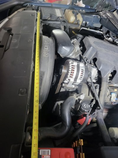

The 8.1 radiator is (unfortunately) somewhat unique and a bit larger, even over the dmax. Center to center of those top two mounting bolts is 42.0" (pictured lol) I'd say 44-45" overall, cap to cap. Yeah I normally would've preferred to have gone the oem route with swapping in those Tahoe fans, wire it into the PCM and add them in hptuners. But to fit, I would already be in custom shroud territory... and some efan/8.1 posts had me worried that tahoe cfm numbers can't support 8.1 + towing... so I decided I would make two of these fans work after coming across this amazing webpage https://www.240turbo.com/BrushlessFans.html They are fairly available, but a bit pricey. On fleabay they run $250-300+tax each but I managed to get both for $250 locally from FB, 2016+ Camaro SS/ZL1 fan, PN 84100128. All-in I'll probably be about $500 spent and still hang on to my original fan and shroud for a bit.

What I was saying is that a stock system that all you have to do is fab the mounts and may be big enough, 2 fans, that would bolt in easier.

All good that was my first choice when I was researching this. Based on what I was able to find, I didn't think they moved enough air. I believe the tahoe fans come in 5000-6000 cfm combined. I think the consensus is my factory fan is around 9-10000. These measured at 5600, so 11200 for two. Everyday use I don't think the difference is a big deal, I just don't want any issues at the extreme, like towing. I found some duramax efan conversion threads that worry about this and sort of drew my own similar conclusion
I should be able to start work this weekend and get a thread going with more info.

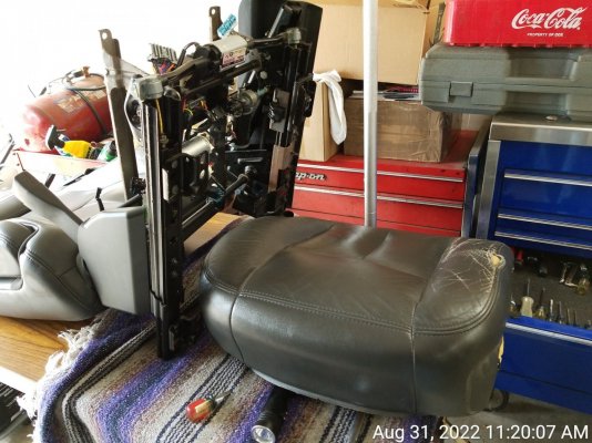

IMO removing the seat is pretty easy, and worth it to make easier access to all the various connectors (if you've got power/heated/blah blah seats like I had.) Unplugging a few of those were tricky even with the seat out. Armed with the knowledge the edges of the sheetmetal are razor sharp, I still managed to cut myself a bit. I can't imagine doing all that with the seat in place.

Yeah, that's kinda what I'm saying - you have manual seats, no connections to pull. On a power seat there's a lot of connections and several of them are hard/maybe impossible to reach with the seat installed.
Still, it's easy to get the whole seat out to work on it. From door open to door closed, including vacuuming while I had the seat out, it took me maybe 1.5hrs to replace the cover for the bottom cushion.

Yea, just yesterday I removed a front seat on a 2005 Tahoe for access to the brake pedal removal for bushing replacement. E18 female torx at front and E14 female torx at rear and seat came right out, after popping a plastic cover off of the 2 harness plug ins, for access. Just the R&R time was about 30 minutes.
