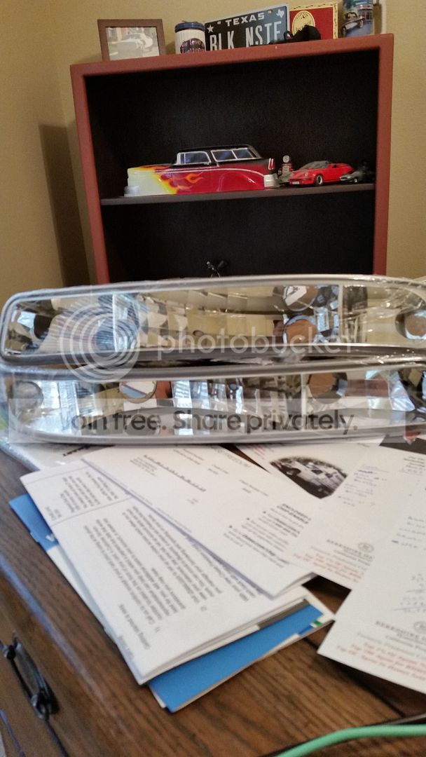

To add insult to injury, I ordered new clear corners over the weekend so I could start getting ready to do some color matching and miscellaneous stuff. Well the corners showed up today...
